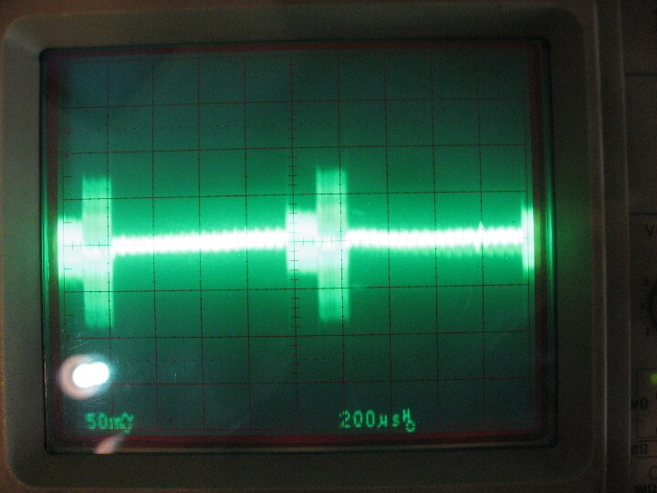

You can’t ever get more than one USB cable away from your noisy computer, so you should consider your environment very carefully with those. It’s not like XLR microphones which can be on the next floor from the MicPre. No, I’m not joking.
USB microphones are the ones that occasionally suffer from Frying Mosquitoes for which there is no known convenient cure.

USB preamps tend to have better noise rejection on the power supply than USB mics - they generally have more physical space for building in supply regulation. USB mics tend to be fairly tight on space, which makes supply regulation more difficult and more expensive.
To be fair, it is not entirely the fault of the USB device. The power supplied by many computers is much more noisy than is desirable for high quality audio applications. Again that largely comes down to cost and size, but this time on the computer side. As USB is mostly used for printers / scanners / external drives and such like, low noise is not a high priority for most computer manufacturers, as long as it does not cause a problem for “normal” USB devices. High quality audio devices on the other hand, can be very susceptible to noise.
The high point of sound damage is “Microphone” and “USB” in the same sentence. Flynwill found this damage in a non mic-level UCA202, but he had to work at it—drag out the scopes and meters. I found my all too obvious damage in a mic-to-usb adapter and most of the other people with mosquitoes are on USB microphones. Combining a super sensitive audio amplifier with ratty USB power is deadly.
Here’s a picture of the source of the “frying mosquitoes” in my case.
This is the USB power, measured inside my UCA-202 while in service. What is most interesting is not the burst of HF noise, but if you look close superimposed on it is a much lower frequency pulse about 100 uS long with a period of 1 mS (1 kHz). The computer supplying the power (via USB) is a small desk side with an Intel Motherboard that serves as my Home-Theater PC.
The UCA-202 actually uses pretty good design to isolate it’s input amplifiers from this noise. However, the issue in my case was that there were multiple ground paths. The UCA-202 is being used to digitize LPs from the stereo system. That stereo system is also connected via RCA cables to a Sony TV and to a CD/DVD player. The CD/DVD player is connected to the TV via HDMI as is the computer. So the issue is that those other ground paths between the UCA-202 and the computer are probably of lower impedance than the 24 gauge wire in the USB cable with the result that the noise ends up in the input. Not very much, somewhere around -85 dBFS, easily masked by the surface noise of a typical LP, but annoying none the less. I cured it by modifying the UCA-202 with an external 5V power supply.
