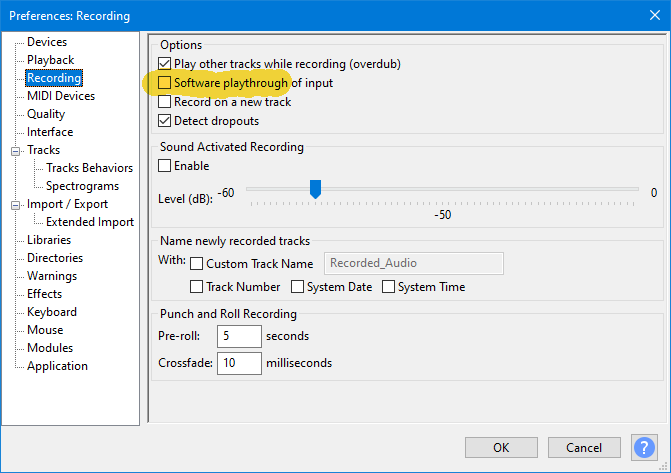

When recording from the internet,
need to ensure something called “software play-through” in Audacity preferences is not ticked,
otherwise feedback squealing occurs.
Also it’s possible to inadvertently record from the computer’s built-in microphone, which would produce a lo-fi distorted recording of what the computer is playing. If that was the case, all sound in the room would be recorded, e.g. if you clapped your hands it would be on the recording.
