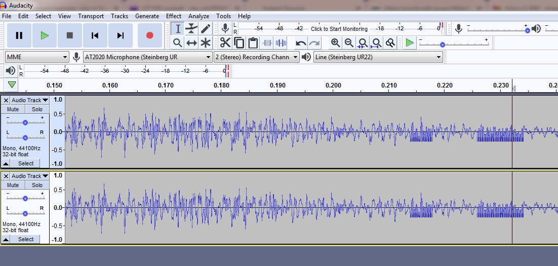

I’m seeing random glitches popping up at intervals on the LEFT channel only during my recording sessions. These glitches can be seen in the waveform and also heard on playback. They intermittently come and go. I have attached a sample waveform to illustrate. Do these glitches look familiar to anyone?

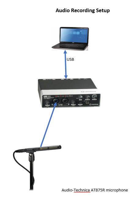

My system setup is as follows
Audacity: Version 2.4.2
Dell latitude laptop
OS: Windows7 Home Premium
Type : 32-bit
Processor: Intel 2.5GHz
RAM: 4GB
Audio Interface: Steinburg UR22 USB Audio Interface, 24bit/192KHz
Microphone : Audio Technica AT875R w/pop filter - Connected via XLR cable to left channel

That doesn’t look like anything I’ve ever seen before.
I’m a little lost about the display. That’s a recording and one copy, right? They appear to be the same thing.
Drag-select and File > Export one of those as WAV (Microsoft) 16-bit and post it here on the forum. Scroll down from a forum text window > Attachments > Add Files.
We need to be able to analyze it in detail. Since you have two of them, you’ll have to work with only one and File > Export > Export Selected Audio. If you don’t do that, the Export will try to add the two of them up and distort the waves.

Your setup is a pair of microphones plugged into the Steinberg UR22, which is then connected to your computer via USB?

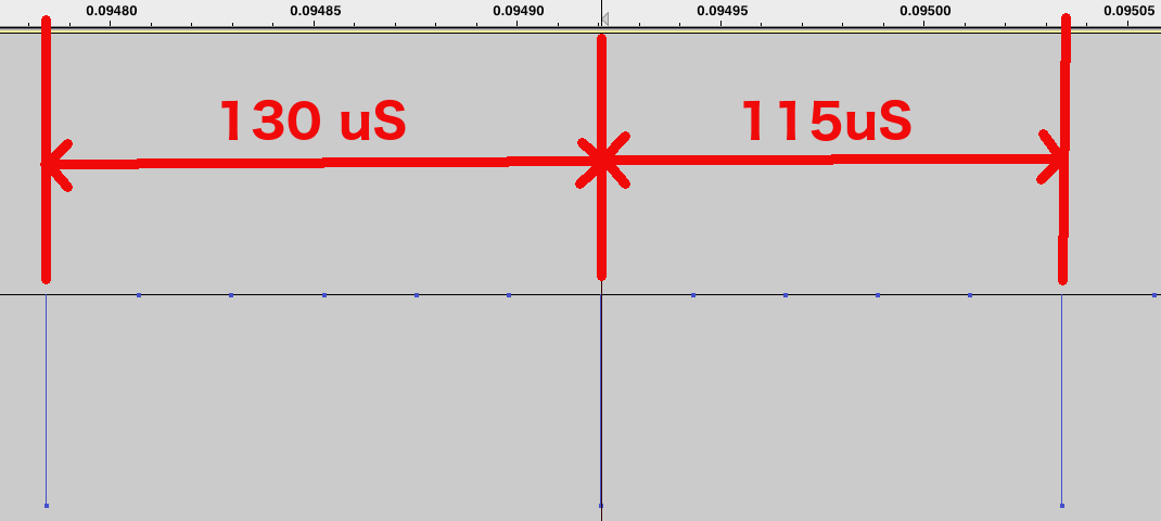

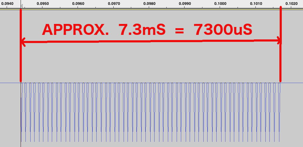

That definitely looks like data.
Taking into consideration the sample rate you used (44.1 KHz), the “recording” of the data won’t be truthful, however going but what we have…
A long “burst” or packet, which could be a pre-amble:
Zooming in further, we can see what appears to be each individual bit.
Note how some are longer than others.
Either the shorter one represents a logic “1”, or vice versa for a logic “0”.
The timings are approximate, but certainly show that it is almost 100% data interference.
