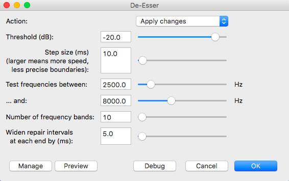

Run Mastering Suite, Noise Reduction, and then the DeEsser. Those DeEsser values are factory. I have no idea what some of those settings do.

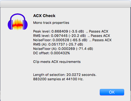

Run ACX Check. I expect it to pass and I expect it to sound reasonable.
OK, no I don’t actually expect that, but I have no idea what’s going to go wrong.
