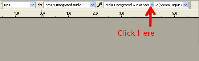

Click on the downward pointing arrow beside the microphone symbol under the recording VU meters and select "Start Monitoring".
I have no such arrow. The screenshot is from the Mac version. What should I do?

This is a screenshot from Windows XP

Hi, welcome to the wonderful world of audio recording!
Another method of turning on monitoring (at least on Windows, anyway) is to do a single left mouse click anywhere within the meter itself.
Anywhere within the red box should do the trick; green box contains the “downward pointing arrow” of which the tutorial speaks.
