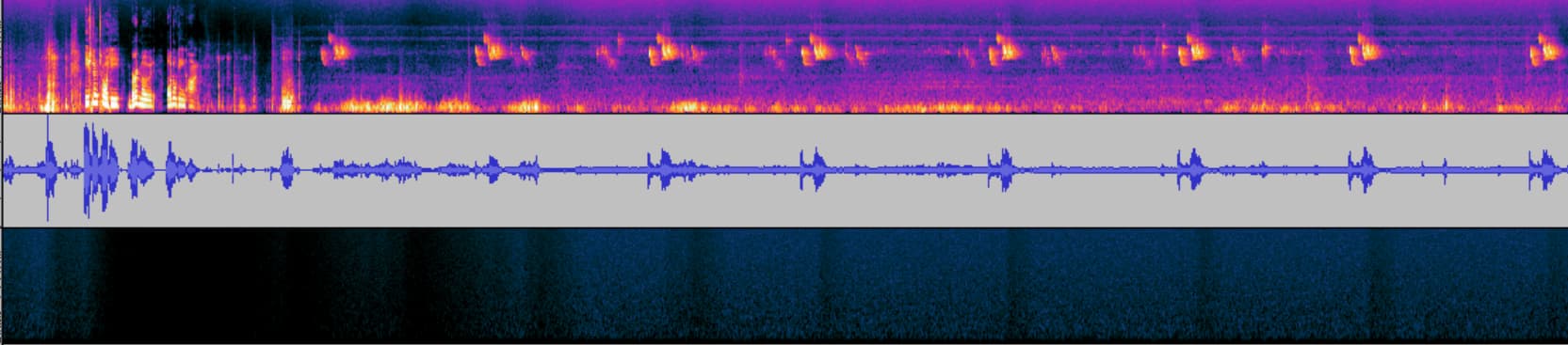

Things just got a little weird. I just connected a mono XLR microphone into one of the inputs and set my source as 3-4. There are two XLR inputs (3 and 4) and I plugged it into #3. Now, however, is still outputs a stereo file, however, one channel’s track is populated normally, and the other has a little noise.
So, If I now Mix stereo to mono, and export the result, the file size is also exactly half the file size as the original. I will call the vendor tomorrow regarding the noise on the right channel, but for now, I’m just checking whether the exported mono file is still a perfectly accurate representation of the full sound. Also, I realize this forum isn’t for recorder support, but does anybody know whether this noise on the right channel that doesn’t otherwise match the left channel is normal for my recording setup?
Please see the spectrogram for what I’m taking about:
Interesting is that when I switch auto-gain to off, the noise on the unmatched right channel is consistent:
If there could be noise on the right channel, discard it: split stereo to mono, then remove [ x ] the unwanted track.
