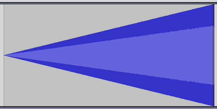

To illustrate the problem, lets take a 20 sec faded white noise:
If I do it in two steps (first RMS, then in another prompt, EXTRACT-ABS), I get first RMS-ed 2 sec signal:
2sec RMS-ed
then 1sec with EXTRACT-ABS (the expected result):
1st sec of 2sec RMS-ed
If I would just stretch the 0.1 sec (produced by (extract-abs 0 1 (rms snd (/ sound-srate 10)))) with the force-srate (as Steve suggested), I would get a different (incorrect) result:
0.1 sec stretched to 1st sec of 2sec RMS-ed
As Steve has explained above, the RMS function passes to the following functions the new sample rate of the signal (as I suspected in my first post). Therefore, it seems, the only way to fix it would be to take into consideration this behavior when EXTRACT-ABS comes after the RMS:
