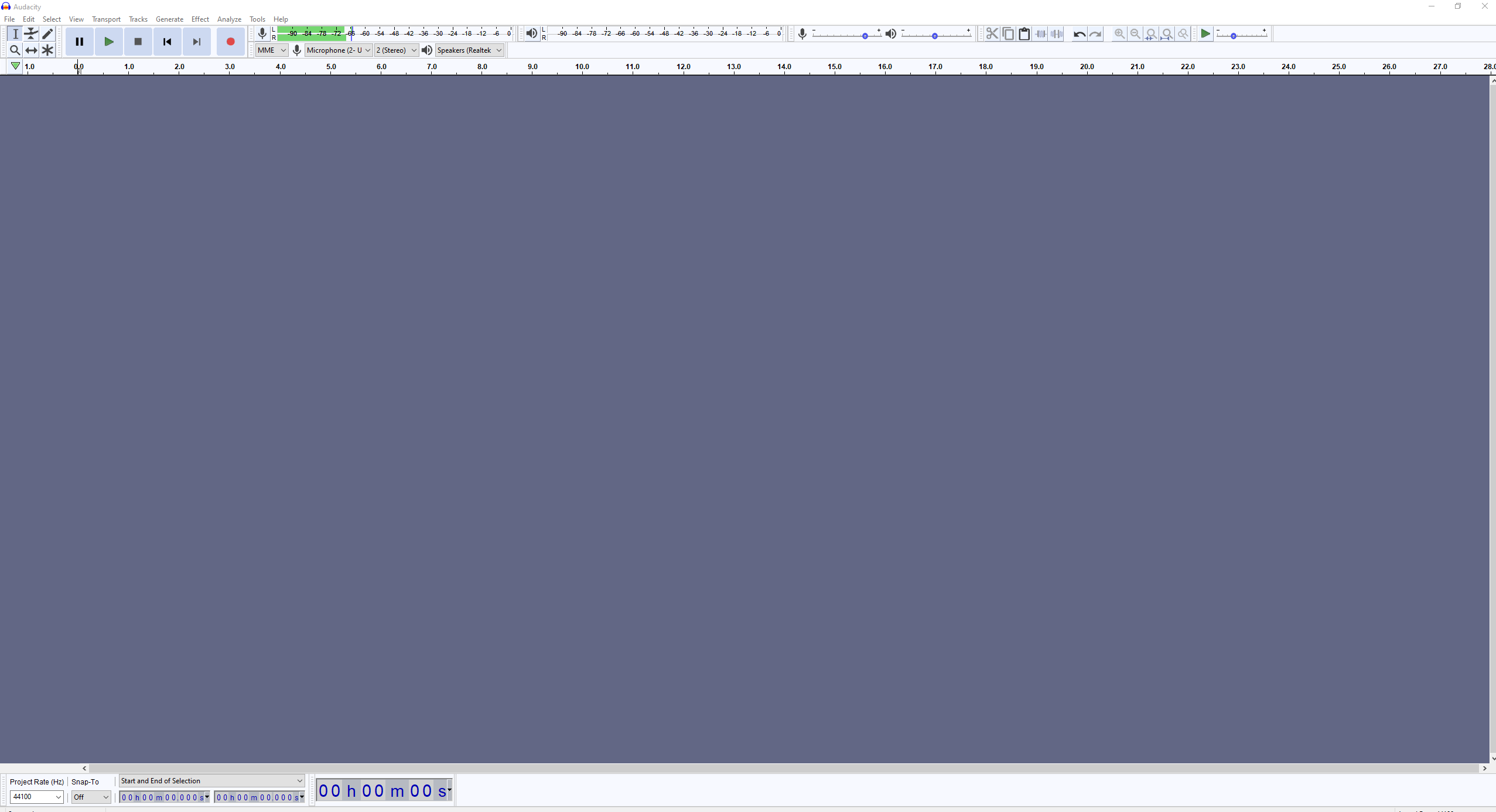

My Audacity layout is a little wacky, but it’s handy if anything goes wrong.
I pull the meters across the whole Audacity window. The left and right extremes of the meter are drag and positioning clickies. As you drag the meters around, the other windows should move out of the way. I change the lower (quiet) limit from the default -60dB to the maximum for 16-bit recording, -96dB.
Audacity > Edit > Preferences > Interface > Display > Meter.

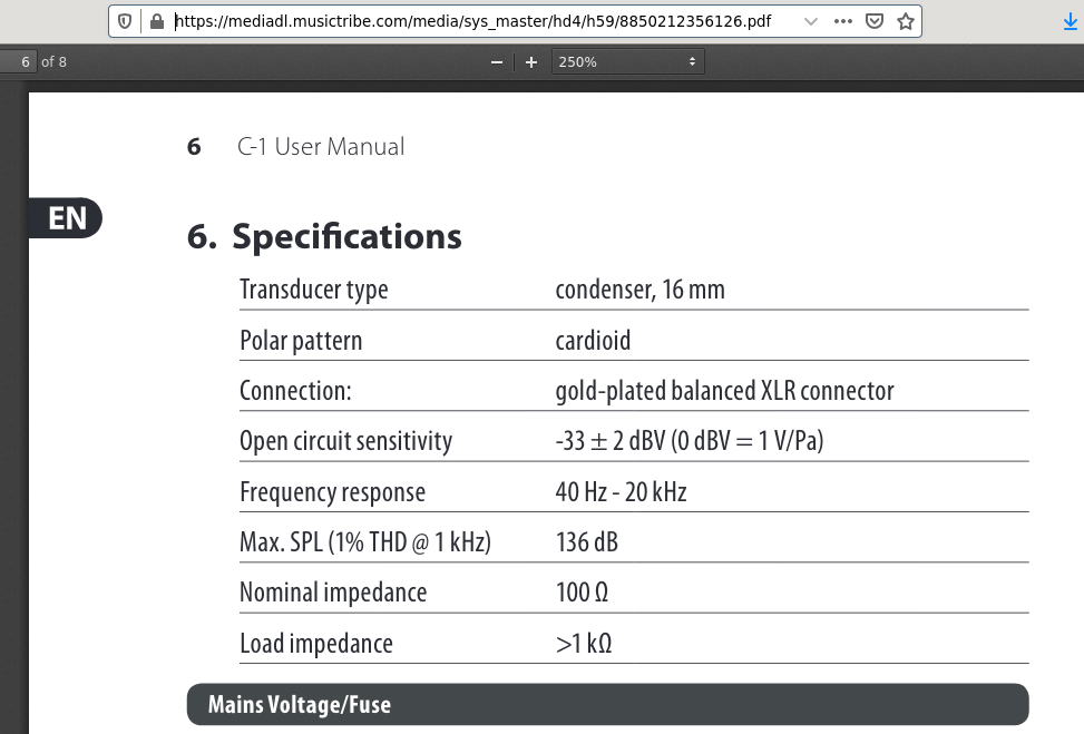

Ominously the C1 specifications do not include ratings for signal-to-noise or self-noise …
