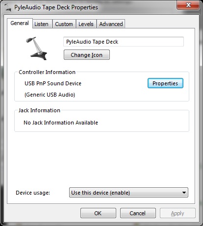

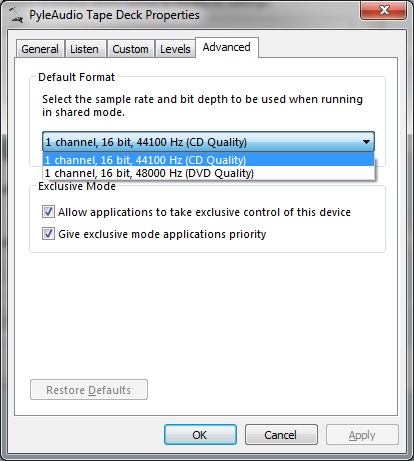

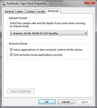

Ok, I’m having the same issue except with a Windows 7 PC. Running Audacity 2.1.2. PyleAudio PT659DU using the USB connection. I do not get an option for 2 Channel. Has anyone mentioned whether switching to a RCA to 3.5 mm cable, instead of the USB cable, solve this issue?

Weird… I’m going to guess it’s a driver problem. You might try updating the drivers, but it should already be using the regular Microsoft supplied drivers so there shouldn’t be anything tricky about it…

I think it’s a limitation in that specific Pyle device, so there is no solution using the USB cable.
