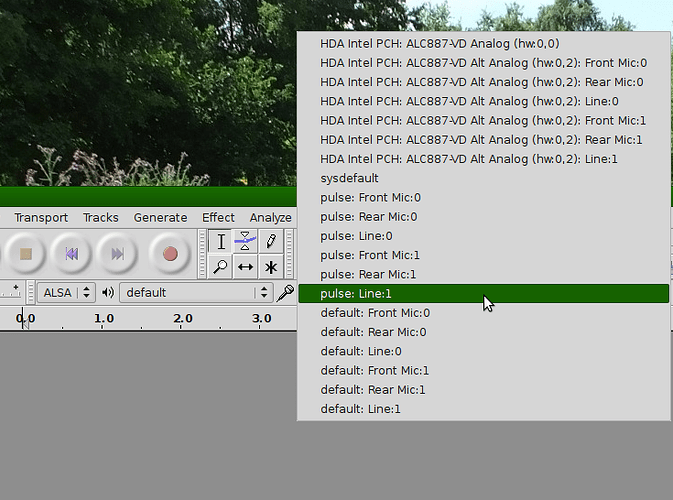

However, are you saying I should alter things from the options shown highlighted here:

There should normally be a “(hw:0\0)” item in the playback settings (in the device toolbar), but you don’t currently have that, probably because something else is still using the sound card. Try rebooting (or just log out and back in again) and then start Audacity. The most likely configuration for recording and playback on your system looks to be “HDA Intel …(hw:0,0)”.
The disadvantage of using the “hw” option is that you can only have one application accessing the sound card (Audacity), but the up-side is that Audacity should be much more stable.

I’ve done a re-boot and now see this:
I did run Audacious a couple of times since the last reboot earlier in the day. Could that have grabbed the hw:0.0 ?
