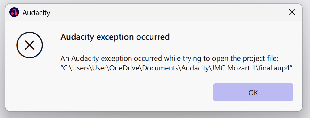

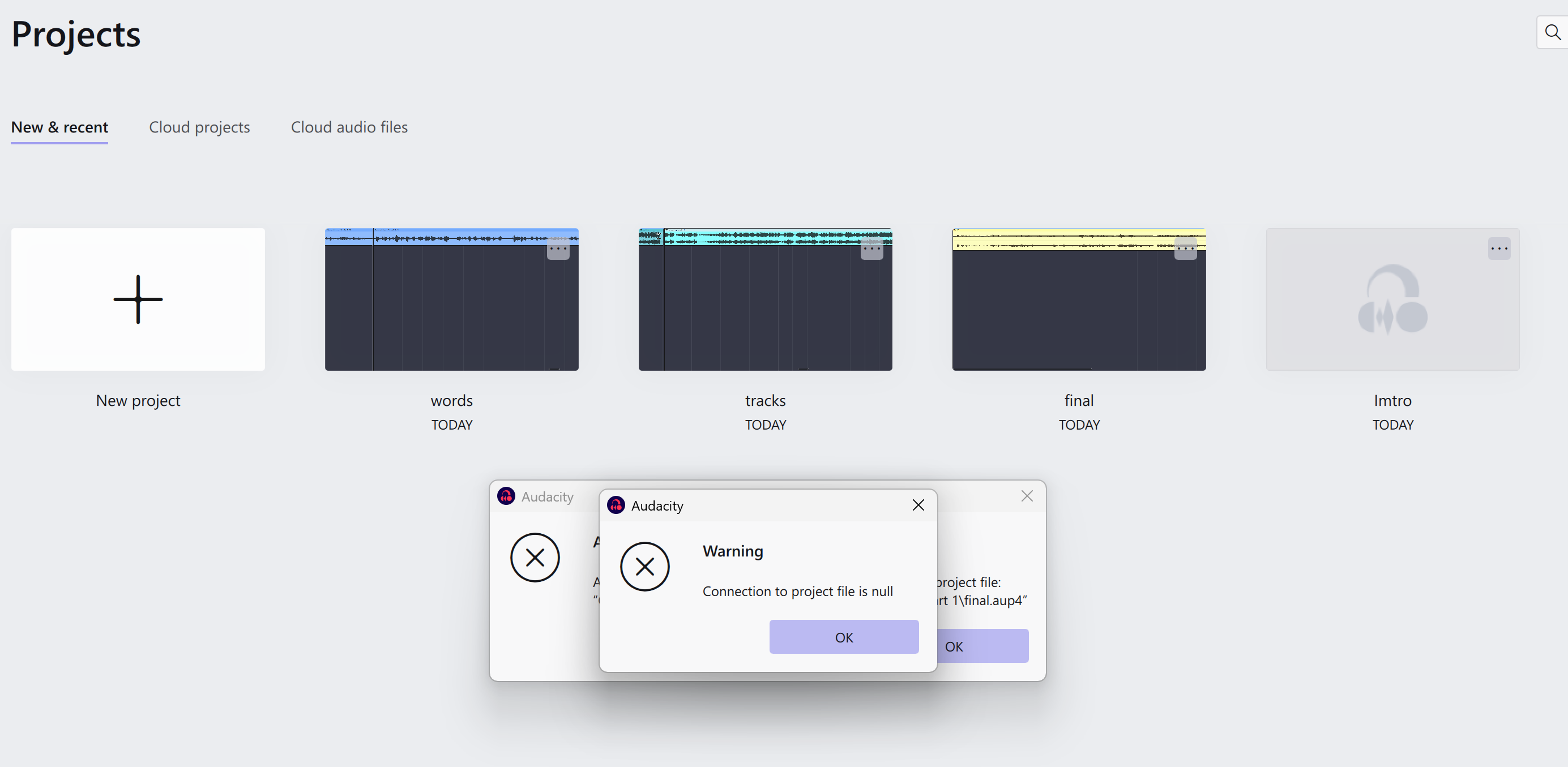

I decided to try Audacity 4.0 Beta.2 version to create my radio so. All was going well I was happy with the recording and organising my songs to play. When it came to making the final file. I had heaps of problems pasting the clips into the new file. Waiting ages for things to happen. It crashed and I tried to open the files and go the following
Just thought I should let someone know.

One, people are going to tell you that Audacity version 4 is just for experimenting. Install the latest version 3 Audacity for real work.
Two, I would bet that the C:\Users\User\OneDrive folder is being synchronized to the cloud. That may have left it locked where Audacity can’t write to it momentarily. Try creating the project in a different folder on the hard drive.
