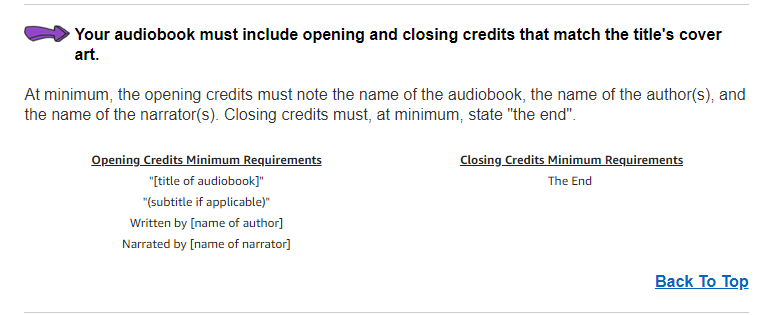

And the ACX requirements do state the closing credits must be a separate file.
https://audible-acx.custhelp.com/app/answers/detail/a_id/6872

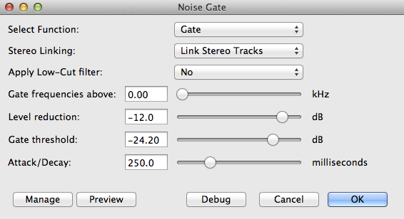

I’m not a fan of Effect > Noise Gate, but that’s how I got it to work.

I cut off everything after about 3-1/2 seconds.
Mastering 4.
Effect > Noise Gate with these settings:

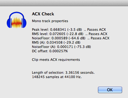

You should probably use that clip just as it is. See in the ACX-Check, the RMS (Loudness) is a small fraction of a dB away from failing. If you have to do this again, record “The End” slightly louder.
Also, see in the blue waves, “End” is a lower volume than “The.” That caused problems.
Again, these tools are designed to process whole chapters with multiple sentences, so errors average out. Can’t do that with two words. Your closing credits is a “chapter” with half of it at the wrong volume.
