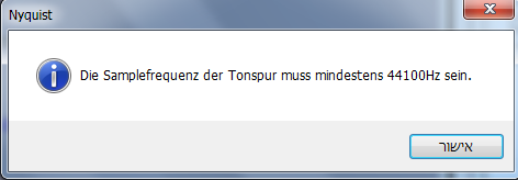

and I getting a problem. it wrote me in german.
what did I do wrong?
I download the plug in, put it in plug in section on the folder where I install the software, restart the software, add sound file, choose on effect “subliminal”
ang got the error
It says the sample rate of the track (above the Mute / Solo buttons) must be at least 44100 Hz. You could change the project rate bottom left of the Audacity window to 44100 Hz, then use Tracks > Mix and Render.
ok its working.
thanks a lot.
