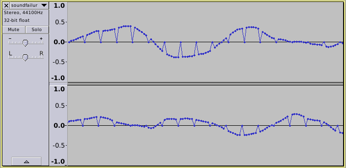

yes, but it ‘looks’ quite different when zoomed in close, and now we can see why it sounds terrible:
As you can see, every seventh sample is at “zero” (on the centre line).
I’d guess that the most likely cause is the sound card drivers.

OK so you can be satisfied Audacity is not at fault, if the problem is the same with every seven samples silenced. That looks more like a driver problem than the computer not keeping up. You could try a different host choice in Device Toolbar but it probably won’t make any difference.
