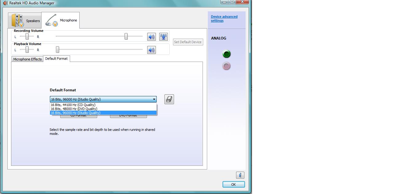

With the Picture above… that is the setting I made when I tried to adjust Microphone setting in Realtek HD audio Manager.
when I was having problem while singing long notes only 1st 3 sec have sound after that no sound or the sound quality totally change. It was because I choose the 1st (2) Option ( 16bits, 44100Hz CD Quality, 16 bits, 48000 DVD Quality)
but when I change it to the 3rd Option, My recording was perfect. this is what I have done on my Mirophone setting.
2nd setting that I have made is the Microphone Boost Setting. that is a Button beside the volume button of ( Recording Volume ) make it to +20.0dB, it might help to get clearer and loader recording from your microphone.
U need to go to Control Penal > Realtek HD Audio Control Penal. but I guess every computer have different version of driver. but i think almost all are the same.
You can check it and give a try…
thanks and I hope this will help all the members here.
when I was having problem while singing long notes only 1st 3 sec have sound after that no sound or the sound quality totally change. It was because I choose the 1st (2) Option ( 16bits, 44100Hz CD Quality, 16 bits, 48100 DVD Quality)

I was still can hear my voice after I did My recording, Is not totally I cannot hear my voice at all… is just when I SING A LONG NOTES LIKE 8 BEATS LONG. I can’t hear the 4th beat to 8th beats… only the 1st 4 beats i can hear… so the problem is came from the Microphone setting as I mention on my previous post with a picture I attached, Is not the sound activated recording problem.
But anyway thanks. Bcz I have already settle this problem.
