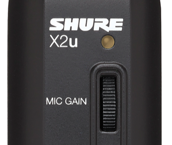

Fuzzy rule, the only time you should be concerned about the position of the knobs is if you get too close at either end. Too low adjustment and it’s likely you have a mismatch or some problem that’s going to cause distortion or other damage.
“I plugged into the computer Mic-In. The knobs run all the way down and the sound is fuzzy.”
Running the knobs all the way up is more normal with home equipment, but that can cause problems, too. Many home systems have terrible time meeting AudioBook Noise numbers. The voice is low but the noise isn’t.
Around 3/4 up is about right, remembering you are not running a sound mixer with big knobs and healthy flashing sound meters. It’s an interface designed for final production somewhere else and we need to be very clear: volume overload (clipping) can be fatal to the show. That’s why the last volume indicator to be removed from a device is the bright (usually) red overload light.
