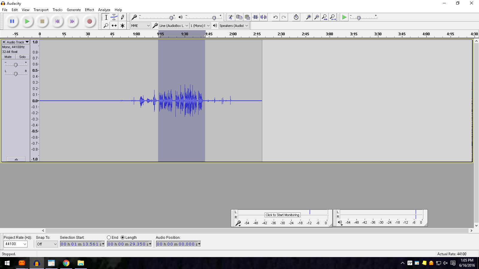

Hi folks
This popped up right after an upgrade to Windows 10. I have included a screenshot to illustrate.
When recording my levels are considerably lower than normal, despite, as you can see the seeeings on the Audacity desktop are normal or above. I checked the level control on my Presonus Audiobox and it too seems normal (roughly at 2 o’clock on the dial.
I’m not sure how to explain this or how to remedy the situation

There’s something in the [u]Audacity FAQ[/u] about half-volume when recording in mono.
Something may have changed with the Win10 drivers causing that issue to crop-up.
