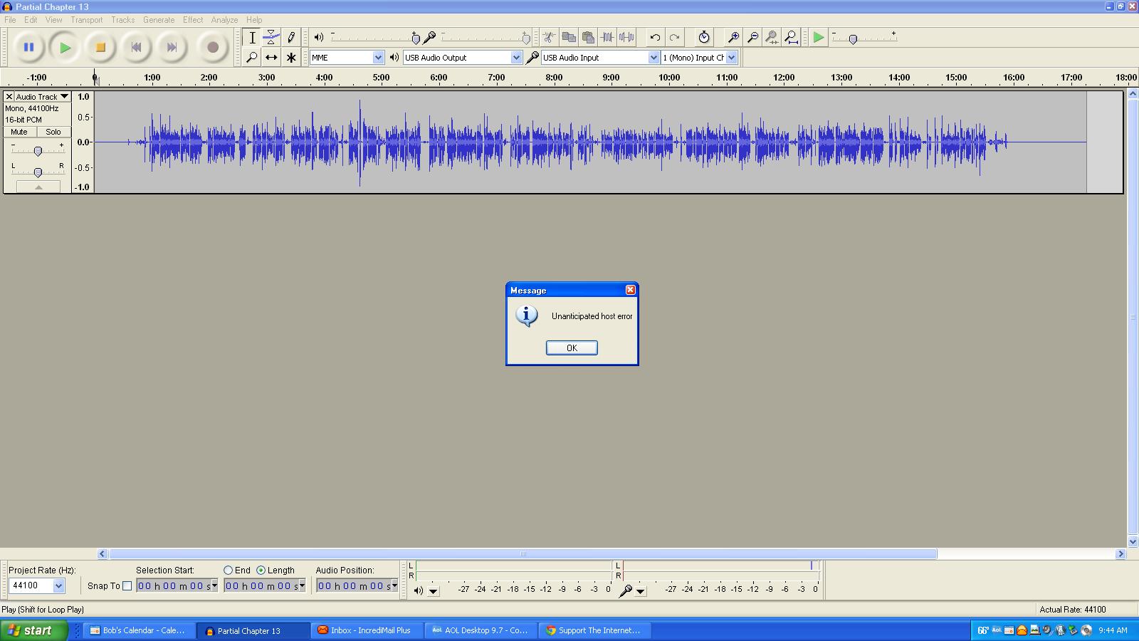

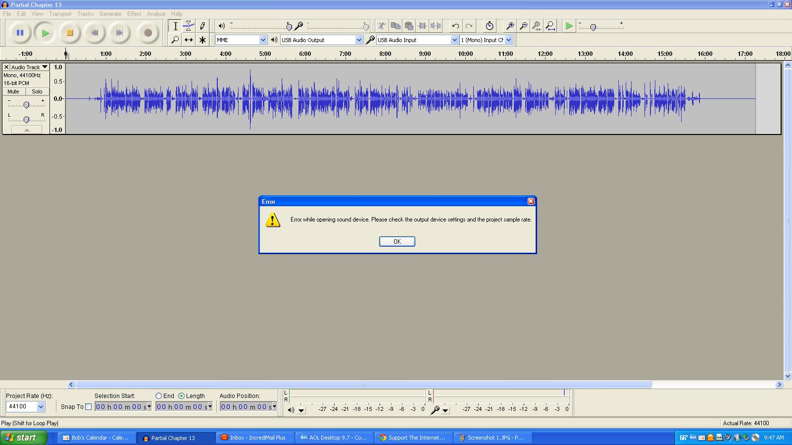

I’m attaching 2 screenshots. This only occurs overnight and I even stopped the overnight backup but i wonder if there’s a conflict with my Norton 360. Could that be doing something overnight? As soon as I reboot it comes back and stays that way.
Screenshot 2
It sounds like “something” is interrupting the sound card. If you suspect Norton, try disconnecting from the Internet and running a test with Norton completely shut down.

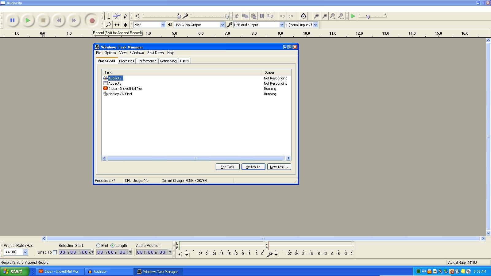

Back to square one. I disabled Norton overnight and the attached screenshot will tell you the results. Honestly I can’t see anything else running during the overnight hours. I’m stumped
Bob H
A reboot always solves the problem.
screenshot attached
Incredimail ?

The Applications tab of Task Manager only tells you about applications. Click the Processes tab to see what else is running (most will be Windows services that you should not shut down, but shutting down Norton may not shut down all the processes it starts).
What is the other Audacity “application” shown in Task Manager - is it a dialogue box that says “Not Responding”?

When you launch Audacity first thing in the morning, are those two Audacity applications there from the outset, or only when it starts not to respond?
You paid money to Norton. All I can suggest you do is click the “Processes” tab in Task Manager and Google for anything unfamiliar.

Whenever I call up the task manager is looks as you’ve seen it
