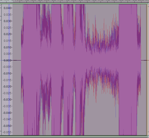

Here is a sample of the digitization from the Revox machine.
Can you hear any hum? I’m not sure if I can, its pretty low down.

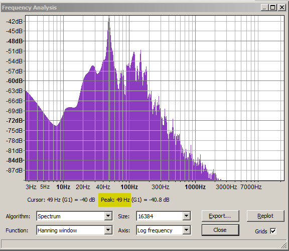

I can’t hear mains hum on your Pete Seeger interview, but I see there is a peak at 49 not 50Hz …
A possible explanation is the 50Hz hum is on the recording and the tape is running a little slow.
It is possible to notch-out the 49Hz peak, (using the attached plug-in @ Q=11) , but the improvement is barely noticable …

Thanks for looking into this, Trebor, what a fancy frequency response graph, I suppose its generated by audacity?

Yes frequency analysis is on the “Analyze” drop doown menu, then click on “plot spectra” (which produces a graph of the selected bit of the track).
The improvement is visible (and just audible) in the quiet bit: between “I’m not sure” and “one of my own songs”.
the red areas are sound on the “before” which is not on the “after” 49Hz notch …
