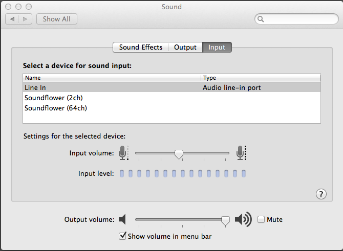

Right. You bought the super screen at the expense of the sound connections. Unless your System Preferences tell you otherwise, that’s the end of the stereo analog connections.
I note you never post that you’ve been into System Preferences and looked at the settings. Have you? Can you post a screen grab? Shift-Command-4 will give you a cross-hair cursor. Drag a box around whatever you want to capture as a picture.
Post the picture here. Scroll down from a text window > Upload Attachments > Browse.
Attached. My speaker volume is always all the way up because I use an external sound system with its own volume controls.
Sorry here’s a screen shot:
Use Ambient Noise Reduction can give you that ‘music in a rain barrel’ sound. Still, even if that works, I’m betting you still don’t get both microphones.
This is what my UCA-202 looks like in System Preferences (attached). That will give me stereo input and output and a headphone connection suitable for overdubbing, sound-on-sound and sound production.
