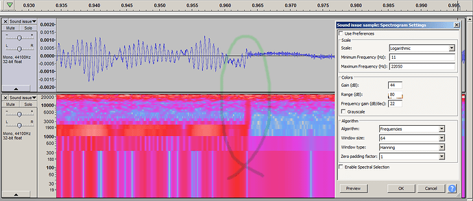

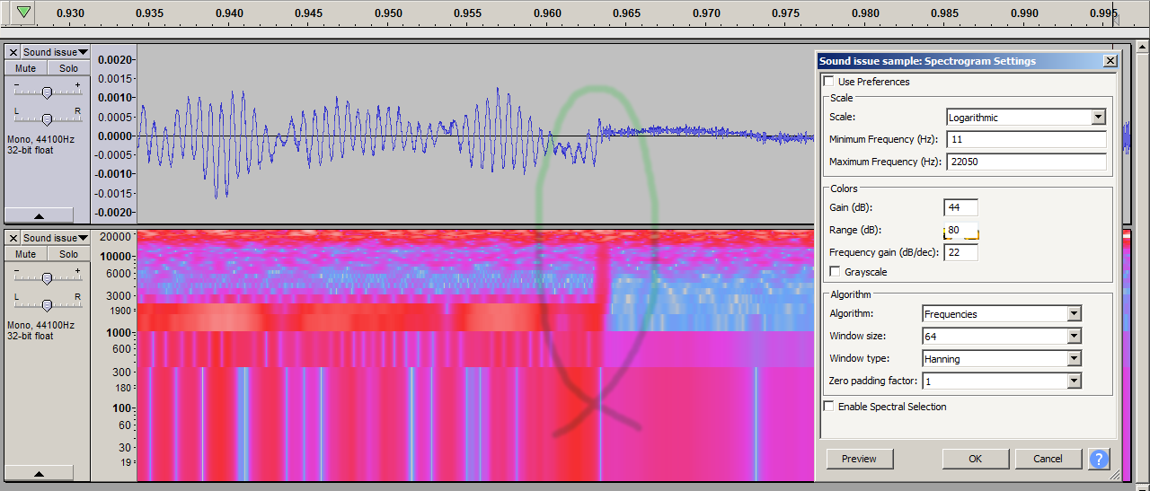

I hear it. There’s one pop at 1.6 seconds and two at 2.8 seconds.
Do they appear if you start to record, but don’t say anything?
There is an abrupt change, as occurs with skipping, which is a digital-glitch, not a real-world sound.
