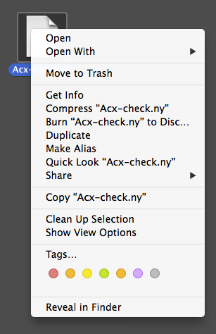

Right click on the Acx-check file, and select “Rename”. This will show the full name of the file. If the file name is Acx-check.ny.txt, remove the “.txt” so that it is named Acx-check.ny.
About that. Some of my machines fail to give me a “Rename” option when I Right-Click (Control-Tap on a laptop). The one that does, doesn’t reveal the hidden extension.

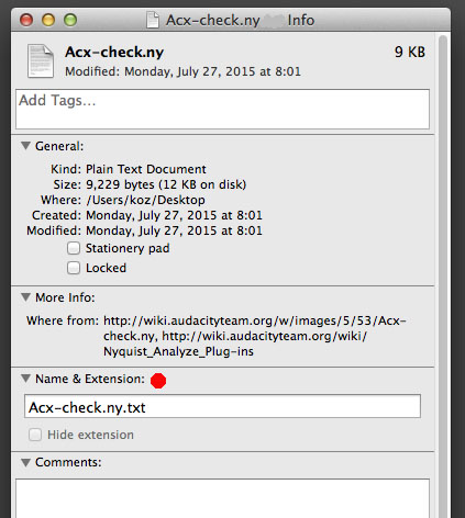

But they all show me the real name when I Right-Click (Control-Tap on a laptop) > Get Info. Read down to Name and Extension.
Delete the .txt there.

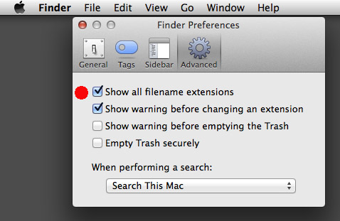

I tell my Macs to never hide anything. Hiding the confusing extensions may seem like a cool thing to do…until something goes wrong.
Click on the desktop > Finder (upper left) > Preferences > Show All…

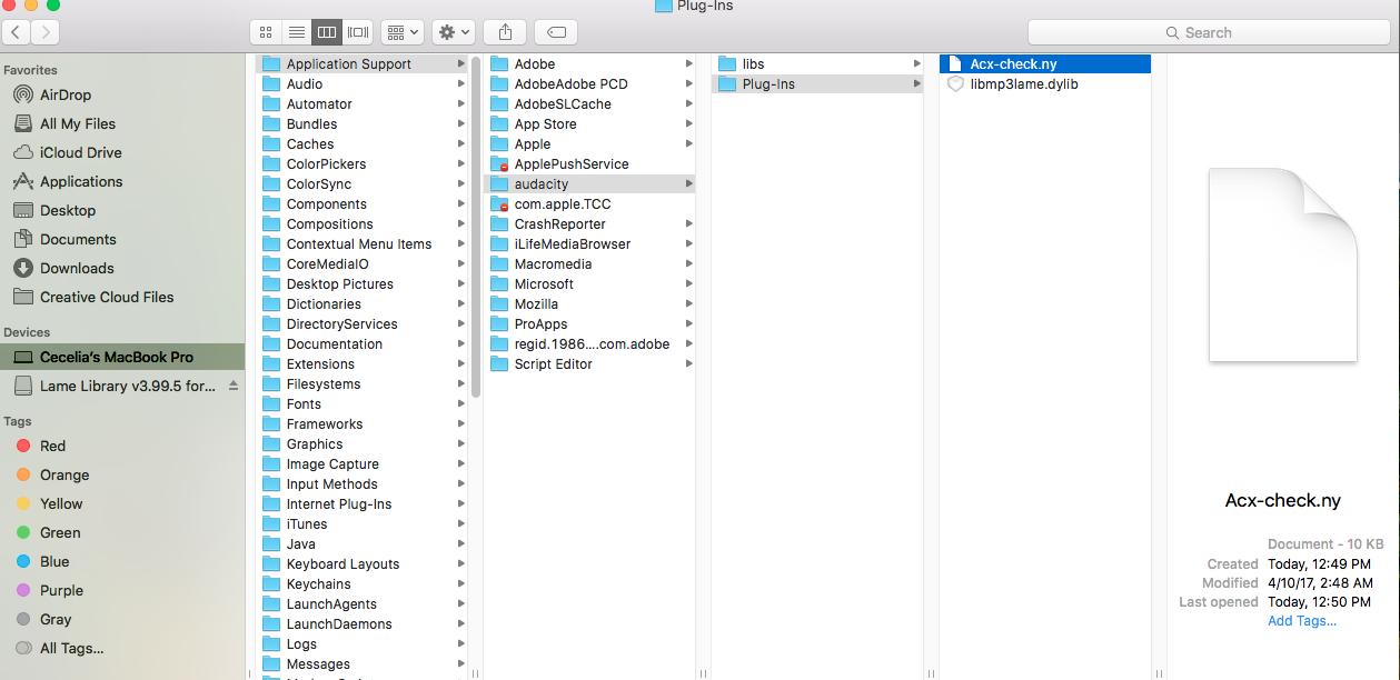

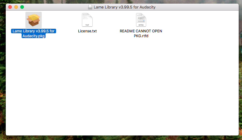

Here are a few screenshots of the downloads and where they are on my computer. Maybe someone can see something here that I am overlooking because I’ve tried all of the suggested fixes over ten times now and it doesn’t seem to make sense to keep doing the same thing and expecting a different result. I must be overlooking something but I dont know what that is…

There are two Application Support folders on your Mac.
One of them is at /Library/Application Support. That is usually written a ~/Library/Application Support. This is the location for the “audacity” folder that contains the “Plug-Ins” folder. This is “your” Application Support folder. Your user Library folder is hidden by default. To get to it, in the Finder, click on the “Go” menu and choose “Go to Folder”, enter ~/Library/Application Support/audacity in the dialog and click the “Go” button.
The other location is /Library/Application Support. This is “your Mac’s” Application Support folder. This is the location for the “audacity” folder that contains the "libs folder.
We can’t be sure from your screen shots which Application Support folder you are showing us. Since it contains an “Apple” folder I suspect it is the /Library/Application Support folder. If that is the case it explains why you can’t see the ACX-check.ny plug-in in Audacity: it needs to be in ~/Library/Application Support/audacity/Plug-Ins.
So, try going to ~/Library/Application Support/audacity and putting the ACX-check.ny file in the Plug-Ins folder there.
As for LAME, it does not show up in the plug-ins manager. See Libraries Preferences in the manual.

Did you double-click the LAME installer and run through the steps?
