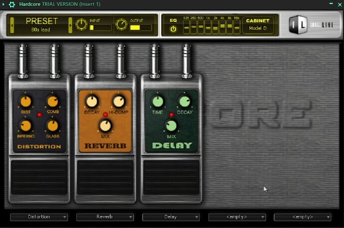

Hi everyone, so I couldn’t find a plug-in that works for Audacity that similarly distorts and amplifies audio as FL studio’s “Hardcore” plugin.
(Demonstrated in this video as an example: https://www.youtube.com/watch?v=Zn8T1jf8xaY&t=100s&ab_channel=ButedMesa)
I do believe it’s similar to Guitar distortion/amplification but I have no idea and I’m only doing this for a short test. If anyone out there has enough experience or knowledge in this area any help would be greatly appreciated :pray:

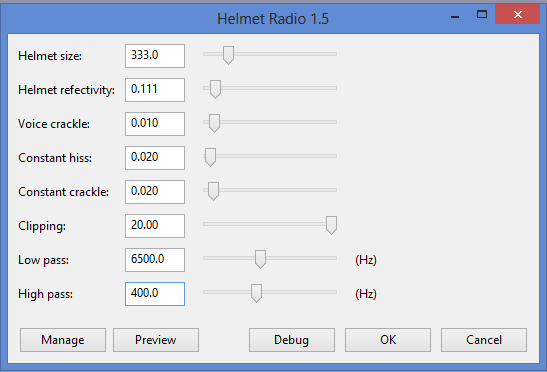

Walkie-talkie/intercom effects can be had with “Helmet Radio 1.5” plugin …
before-after
settings-used

I still think the distortion use is more bass focused distortion because “hardcore” (the plugin used in FL Studio to make the effect) was intended for gituars, but I can’t seem to make it work… here’s an example of me testing them all with comparible audio

The [Helmet 1.5 ]
Settings are an exact copy of perscribed amounts as seen in your previous reply.
If you need more bass, change the high-pass on HelmetRadio from 400Hz to, say, 200Hz,
(I don’t think that will help intelligibility).

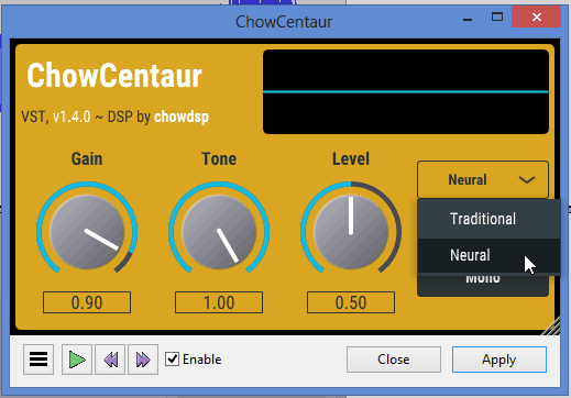

BTW a good free guitar distortion effect that works in audacity is Chow Centaur
two passes - neural then traditional
Two passes at these settings, neural then traditional, gives a realistic strong analog distortion.

Plugin: Chow Centaur [plugin applied twice]
Download: Chowdhury DSP - Products (Scroll down on page)

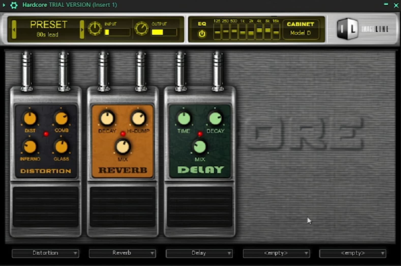

In regards to recreation of the original audio… I think a more suitable plugin would be BYOD (Bring Your Own Distortion), I’m unable to make a comparable set of “Processors” that seem to mimic how the announcer speaks… but the plugin used in FL Studio uses this interface if someone (such as you who may have more experience with software of this variety) could decipher and possibly tell me the translated distortion processes applied…?
For reference, I’ll add reverb and delay later with better VST3 plug-ins, however, I’d much appreciate it if you’ve any advice as to how to re-create the distortion plugin seen here.
