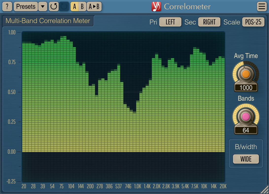

Hi Trebor,
Thank you for the reply.
Looks pretty cool !
