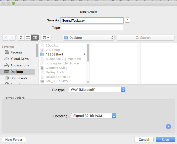

But it’s not that hard to do. Make sure your system is at 48000 and it says that in the Audacity lower-left window.
Export > WAV > and 32-bit is one of the export options.

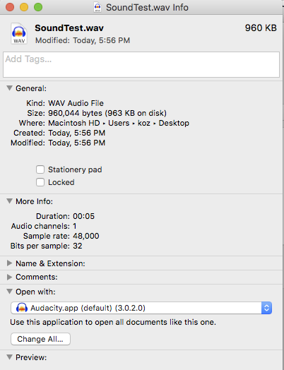

I told the Mac to give me INFO on the sound file and it did.
Note in the middle bunch: 1 channel (mono), 48000 - 32 bit.
The exact specification they wanted.

Record the work, export it at 48000 32-bit, Examine the file with Mac Right-Click > Get Info, pack it up, and send it. Don’t explain anything. Make it appear like you do this every day.
