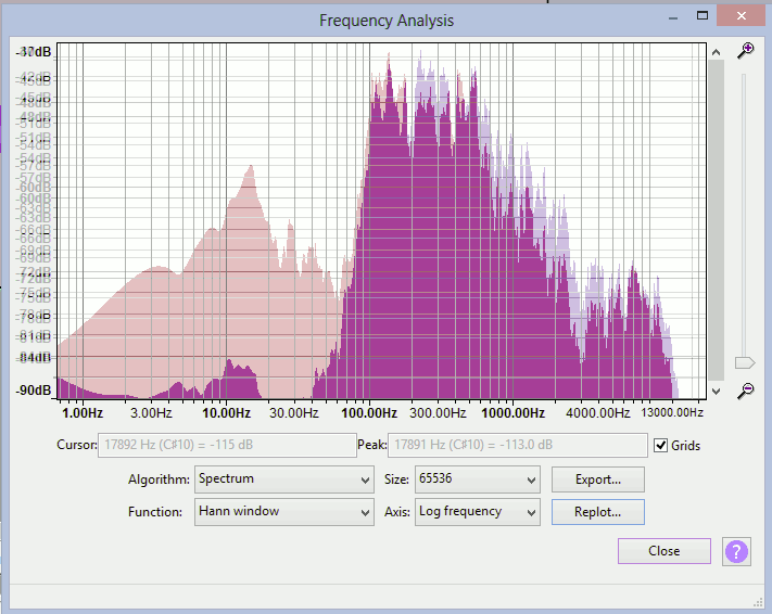

I had to sacrifice some of the bass to reduce the resonance at ~150Hz.
Spectrum is more reliable than by-ear,
as headphones, speakers, hardware & software can affect the sound heard.
I’m not suggesting you slavishly-copy popular vocal talent,
but if you look at their spectrum you’ll see how different you are from them.

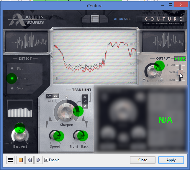

If you reach a stage where you can’t acoustically-treat the room any further,
a free plugin called Couture can dry-up what little reverb remains …
[ I would still investigate what EQ-matching / de-resonate plugins can do ]
