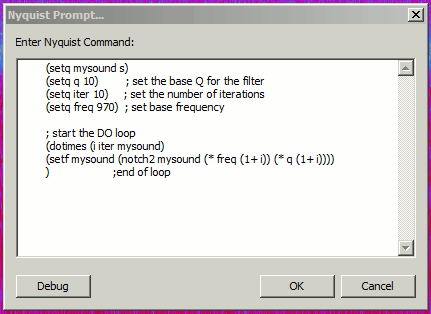

Copy and paste the code below into the “Nyquist Prompt” which is in the “Effect” meun …
    (setq mysound s)
    (setq q 10)         ; set the base Q for the filter
    (setq iter 10)     ; set the number of iterations
    (setq freq 970)  ; set base frequency
    ; start the DO loop
    (dotimes (i iter mysound)
    (setf mysound (notch2 mysound (* freq (1+ i)) (* q (1+ i))))
    )                     ;end of loop
Applying the above code removes the main whine, (which is a 970Hz fundamental and 10 harmonics),
the above code does not remove hiss-noise or the weird bleat which comes in at 0.9 seconds.
