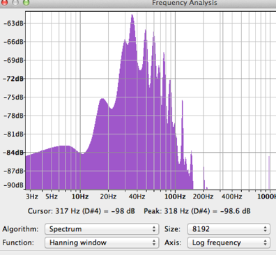

We record church audio using a line in on an iMac from an out on the soundboard and record with the latest stable version of Audacity.
I have uploaded a small WAV sample of a few seconds of “silence” from our WAV file. The usual Noise Removal plugin in Audacity is not successfully removing this. I’d love to know (1) how could this be removed and, more importantly, (2) any idea what this noise is and how it could be introduced?
http://www.sendspace.com/file/9ydy42
Spectrum of WAV sample:
Thanks!

Applying the above code removes the main whine, (which is a 970Hz fundamental and 10 harmonics),
the above code does not remove hiss-noise or the weird bleat which comes in at 0.9 seconds.
