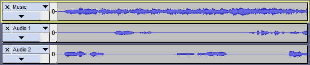

Please help, the Gain and the left right Pan controls disappeared from all of my tracks!
Hello, I need help trying to fig out how to get the “Gain” (volume control) and left
/right “Pan” control to re-appear on my my tracks. The Gain and Pan controls disappeared from all 16 tracks on one of my projects! I can not figure out how to get them to re-appear so that I can make volume adjustments at the trac level. Any help would be so wonderful and very much appreciated, I’ve spent days trying to find the answer! :slight_smile: Sincerely- Dan A.

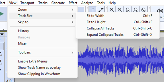

You may have accidentally activated “collapse all tracks”
Then you need to “expand collapsed tracks”
https://manual.audacityteam.org/man/view_menu_track_size.html
Did you try “Menu, Tools, Reset Configuration”…??
