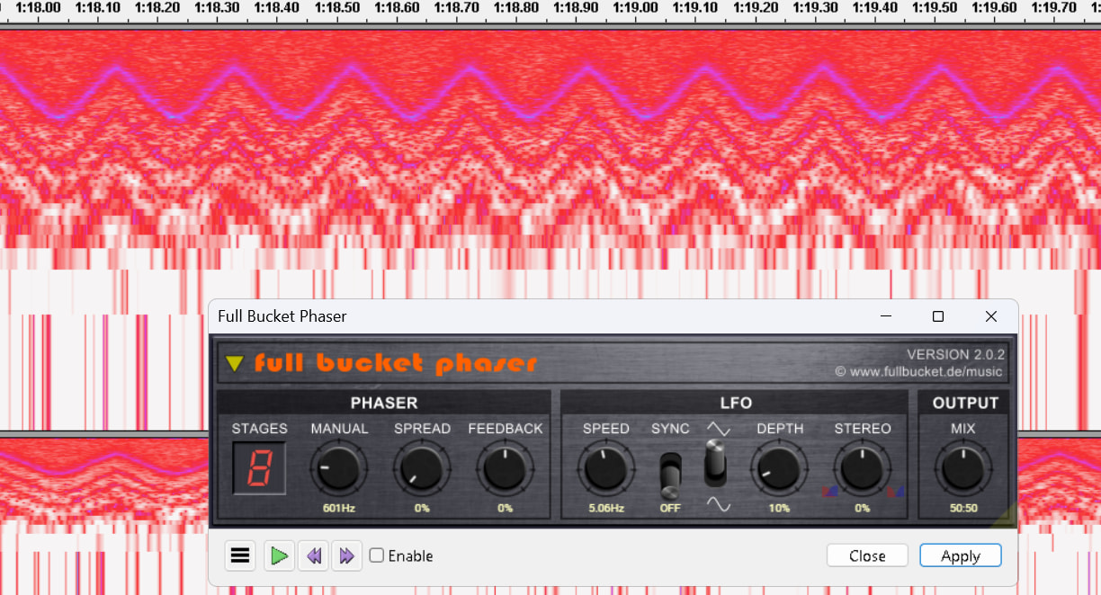

You mention phaser and list two options, but in Audacity, there are several, and I don’t know which I should change and to what, etc. Ideally, I’d need someone to test it and let me know what settings to apply. I know it’s a big ask, but I’ll definitely work on the Phaser and Telephone preset in the meantime. Thanks
Excellent, thanks. I noticed that Ash’s voice is removed of bass and treble, at least to my ears. Therefore, with the Phaser plugins you shared with me and maybe somehow sorting the telephone EQ, this might hopefully work. I’m editing right now, but I’ll make another attempt very soon. If I manage to do it, I’ll post the settings and finished clip here.

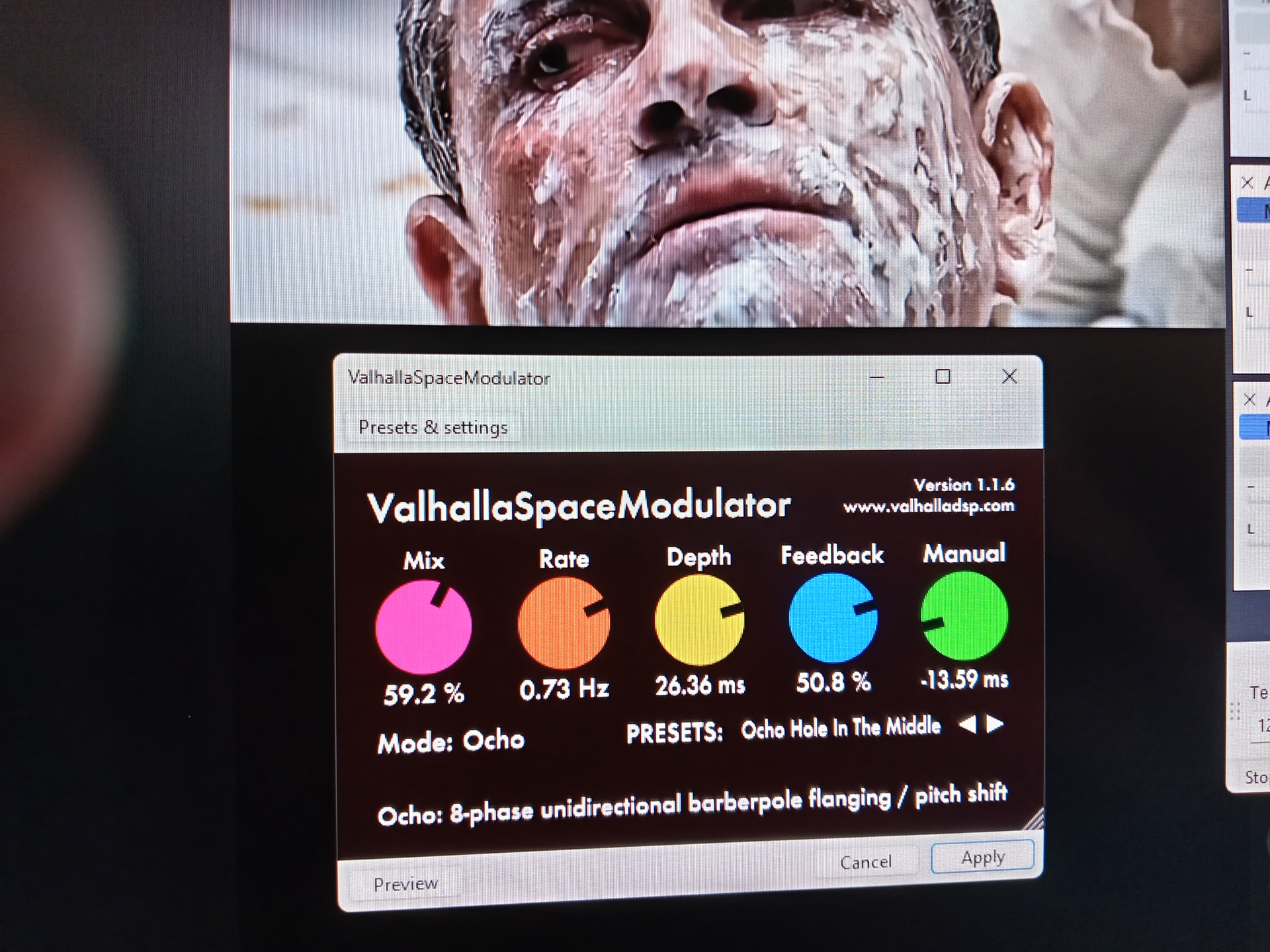

It isn’t perfect, by a long shot. However, it feels close. I used Audacity’s EQ preset for Telephone in the curve list. Once I move it into Davinci Resolve and apply my normal settings, I usually use, it should give it a bit more life, etc.

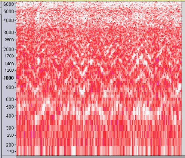

Nitpick #1. The effect in the movie is oscillating ~1.75x faster, (e.g. try 1.25 Hz rather than “0.73 Hz”).
Nitpick #2: In most of the movie clip the effect is still faintly audible between Ash’s words.
If you generate a pink noise track and mix it with your recording, then apply space modulator, then it will be more like the movie. [ and/or disable the noise-gate which makes the gaps between tour words silent ].
