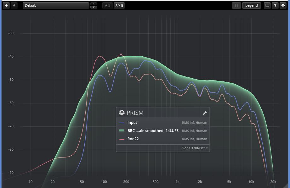

What Have below are two recordings. One processed with my macros created in Audacity. The other is using the onboard processors on the interface and then using amplify in Audacity.
What I would like is to have you listen and say which sounds better to you. Or heck maybe you don’t like either one. That might have me rethink everything!

Ron2 is closer to generic male voice EQ than Ron1, but both are a bit too bassy …
https://www.tokyodawn.net/tdr-prism/ (free)
If you import in the “4Ron2” EQ preset below into Audacity’s equalizer and apply it to Ron2 it will be closer to generic (green).
4Ron2.txt (290 Bytes)
Very interesting. For the record Ron 2 was in fact generated by the onboard processing of the interface. Ron 1 was the raw signal imported to Audacity and processed using my Macro.
About the bass aspect of recording. I turned off the High Pass filter because I didn’t think the low end had enough … oomph. I might rethink that.
