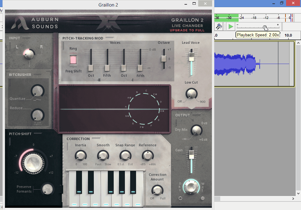

A real-time pitch shifting plugin can do it, e.g. the free version of Graillon2, (which is available in 32 & 64 Bit)

Damn that’s nifty, will try it out, thanks a lot!
