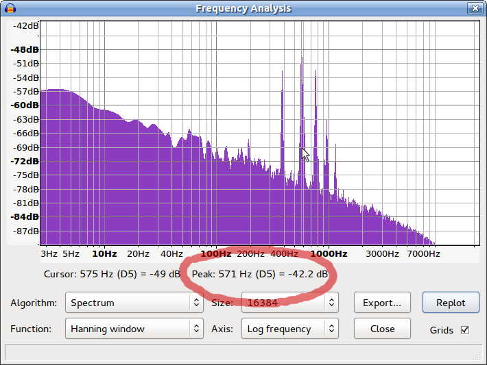

You can find the frequency of a tone by using “Plot Spectrum” (Analyze menu).
Find an “A”, select it, and use Plot Spectrum. The fundamental tone will usually be the highest peak on the graph.
In Plot Spectrum, higher numbers for the “Size” will produce more accurate graphs, though you need to have a big enough selection to use a large “Size”.
Setting the “Axis” to “Log Frequency” is generally easier to read than “Linear Frequency”.

With the “Size” parameter in “Plot Spectrum” set to 16384 then the graph around 4-500 Hz will be accurate to the nearest 1 Hz.
Note that if you hover the mouse pointer over the graph there is a read-out below the graph showing the peak value closest to the pointer position.
