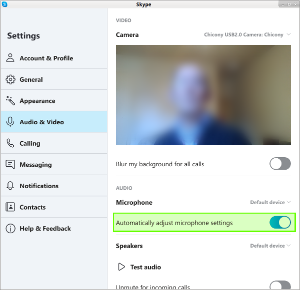

Most VOIP software also have an option to turn this feature off. For example, for Skype:
