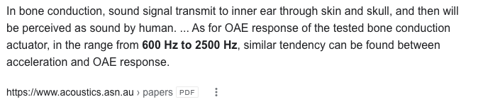

Another factor is how the sound is picked up eventually by the inner ear.

The above is of course assuming that there is enough separation in bone conduction to allow for a stereo field.
You may find that only 3 channels (i.e 2.1) are feasible, i.e. Left “air”, Right “air”, then a center channel (mono)
made from the bone conduction, which keep in mind ,will be in the 500 - 3000 Hz range.
