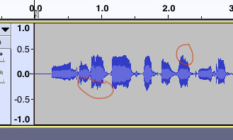

See those little tips in the blue waves up and down.
Those are the peaks. That’s different from the RMS or Loudness.
Those peaks are not allowed to get any louder than 70% on the left hand scale. You can drag the timeline taller to make it easier to see. If you’re watching the bouncing sound meter, that will actually go to -3dB.
