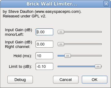

I’ve reworked this limiter effect and (hopefully) made some improvements.
As shown in the above image, I’ve added a control for setting the level that the audio will be limited to. In the previous version this was fixed at 0 dB.
Parameters:
  • Input Gain (dB) mono/Left: [0 to +10 dB. Default 0 dB] Applies gain to (amplifies) the selected audio prior to limiting. If a stereo track is selected, this amplifies the left channel. If a mono track is selected, this amplifies the selected audio.
  • Input Gain (dB) Right channel: [0 to +10 dB. Default 0 dB] Same as the previous control but for the right channel of stereo tracks only. If a mono track is selected this control does nothing.
  • Hold (ms): [1 to 100 milliseconds. Default 10 milliseconds] This control tells the limiter to keep the gain down at the “limited” level for a minimum length of time before allowing it to rise back up to the normal level. Smaller values cause the limiter to react more rapidly to changes in the audio level and larger values cause the limiter to react more gradually. Even with slow (long) settings, sudden peaks will be prevented from exceeding the threshold because the limiter is able to start changing the gain in anticipation of the peak (lookahead). The amount of lookahead is set automatically to ensure that peaks will never exceed the limit level.
  • Limit to (dB): [-10 to 0 dB. Default -0.1 dB] This is the maximum peak level that is allowed. Peaks beyond this level are amplified (attenuated) to this level.
