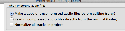

You can get into very serious trouble if you’re using Audacity in its “reference” mode, where it doesn’t make personal copies of the sound files it uses. See Attached picture. The older Audacity versions used to default to the second option. The newer one uses option one as in the picture.
