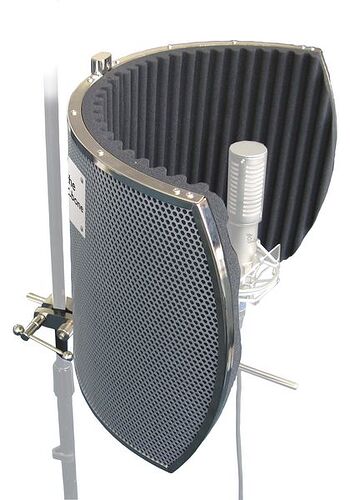

When using a microphone with a cardioid pick-up pattern, echoes can often be significantly reduced by placing sound absorbing materials directly behind the microphone. Suitable materials include things like heavy blankets. There are purpose made devices specifically for this:
http://www.thomann.de/gb/the_tbone_micscreen.htm
Not a bad solution but the noise comes from behind me (my back is to the door) and goes directly into the mic.
Hang heavy blankets, curtains, coats or similar in front or over the door.
