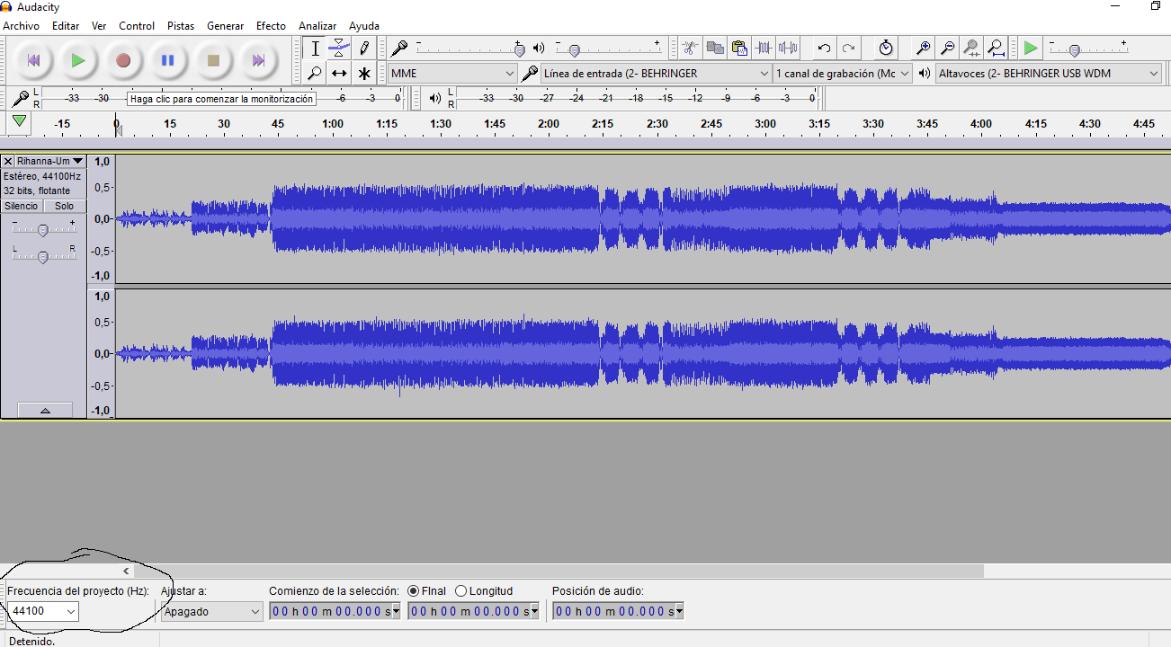

Check that the sample rate is the same in Audacity (in the “Project Rate” box near the bottom left corner of the main interface), and for the device settings for Recording AND Playback in the Windows Sound Control Panel.
I have been trying to repair this the whole day, i just changed the properties of the interface to 48000hz, did the same in audacity AND IT WORKED.
