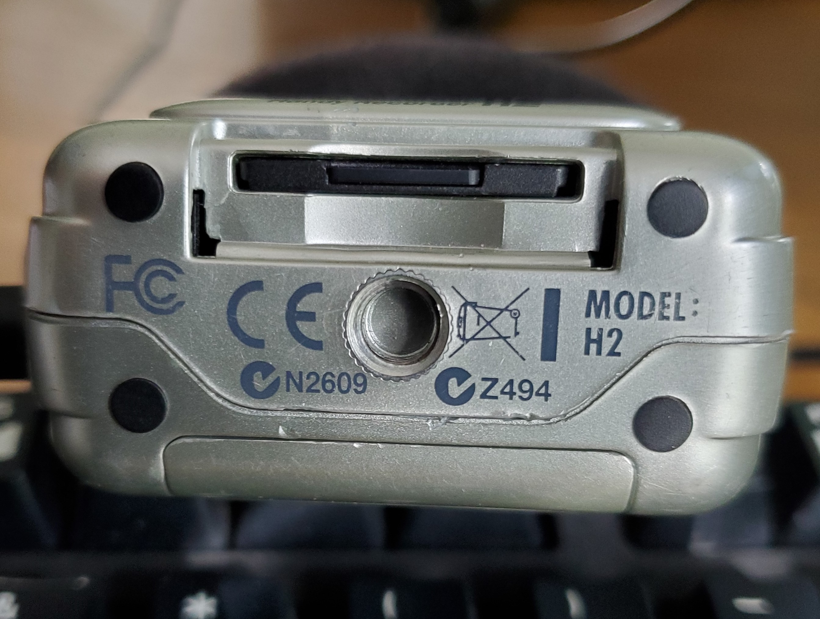

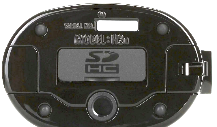

We could be a lot more help if we knew which H2 you had. There’s the original H2 and the newer H2n.
The H2n is labeled on the bottom.

There’s something serious wrong with your voice. As I posted, it sounds like you’re recording in a small closet. Totally off from your desctiption of the room. I’d make detailed suggestions, but we’re still not sure which H2 you have.
So grateful for your help, Koz.
Ta da! It is the original H2. I remember you told me awhile back that this one is the best.
If it’s in good shape, yes. We should also remember it could be as much as 14 years old. I see the memory chip cover is missing. Historical searches tell me the brief, original issue of this recorder had microphone problems.
