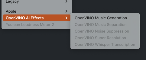

I installed OpenVino and it did not uninstall Audacity. However, I chose to only install the Music Separation piece but the Music Generation piece was installed instead.

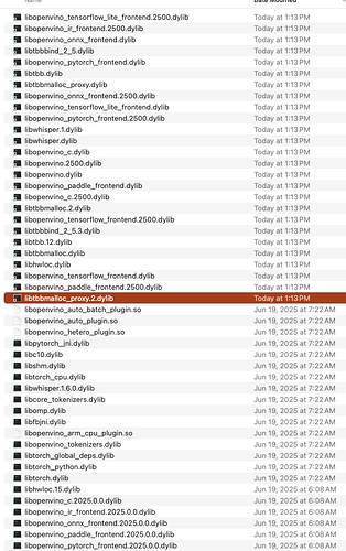

FYI, I installed this today and on June 19th. The earlier version is the one that uninstalled Audacity. I’ve got 55 dylib files that probably come from OpenVino.
I’d really like to get these off cleanly and perhaps start over when things seem more stable. What’s the best way to do that?

Hi @mgaert, to use Music Separation you just need to select some existing track first. It is showing up as greyed out in your screenshot, only because you don’t have anything selected. Music Generation of course, is the only one that doesn’t require any selections – which is why it shows as available here.
Thanks that worked.
