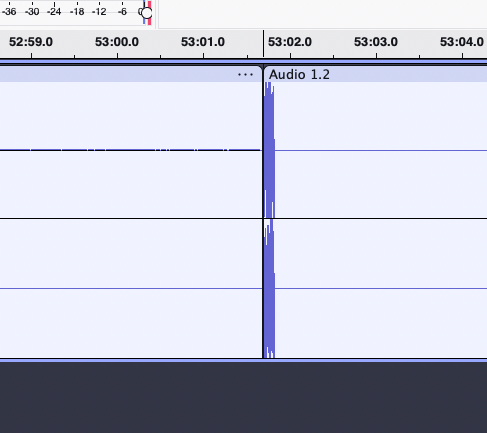

Recording stream audio. But the blurp can occur before the stream is turned on.
Here is a blurp. I stopped recording and resumed it. Stream was stopped. Took 3 tries to get a silent start.
