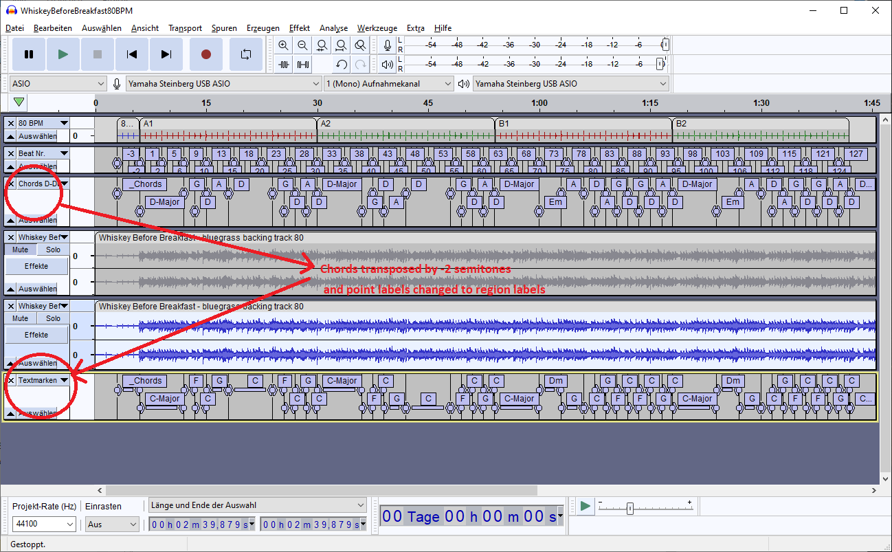

Audacity offers a high quality function to pitch shift audio. To the audio I often add a label track with the chord changes, which I either created manually or automatically by the chord recognition program Chordino (NNLS Chroma). For automatic transposition of these chords I have not found any macros or plug-ins in this forum. Therefore I tried to write a Nyquist plug-in myself that solves this simple but boring task automatically:
The plug-in given below uses optionally either the last found label track or the last found label track whose name begins with “Chord”. In the found label track, all labels that begin with a chord letter (C/D/E…A/B/c/d/e…b) are transposed by selected semitones. The rest of the label remains unchanged. As 2nd character # for sharp or b for flat can be used.
A new label track is inserted with the changed chords at the end. Labels that are not recognized as chords are taken over unchanged. Optionally, point labels can be converted to region labels (and vice versa). If a pitch change of 0 semitones is selected, all labels are taken over unchanged. The Nyquist plug-in requires exactly one selected audio track the label track refers to, and this also determines an optional offset if the audio track does not start at 0 in timeline. If a label track is selected in addition to the audio track, then Audacity does not create a new label track, but inserts the new labels there. In addition, the Nyquist plug-in can change the pitch of the selected audio itself using a Nyquist function in a second pass.
