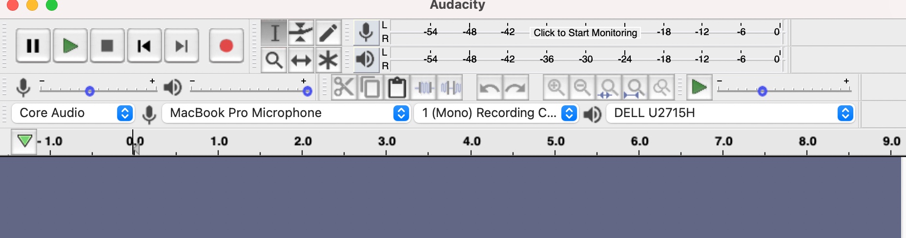

I have followed all of the suggestions to do everything from check my privacy settings to adding a prompt in the Terminal. I cannot get the cassette playing back from a good Sony cassette/CD player to work with Audacity. I tried it on both my new Macbook Pro running Big Sur 11.4 and my older one running Catalina 10.15. The sound is just not coming through the cable so I cannot record. I have an audio cable attached to the mic jack on the Sony player attached to a splitter since neither machine has a line in to ensure that the input picks up the mic. I only have one option on Audacity for input, which is MacBook Pro Microphone. WHAT AM I DOING WRONG?
Oh - and I am using the latest version of Audacity 3.03
Before we go whipping past that, the built-in microphone does work, right? You can speak or scratch the microphone and sound arrives?

One more clue! When I go to System Preferences > Sound > Input, the “External Microphone” shows up with signal! However, Audacity will only give me 1 choice - Internal MacBook Pro Mic. How can I make Audacity show the External Mic?
Try stereo input rather than mono. Audacity used to have a quirk where it would refuse to connect to anything if that setting was wrong in either direction. Another quirk is the order of application. If you start Audacity and then connect an audio device, Audacity won’t see it. Either connect the device and then start Audacity, or Transport > Rescan…
