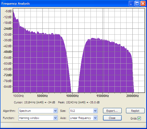

Can be done with Audacity’s equalizer, (see attached screen grabs)
12KHz-14KHz notch with equalizer.zip (98.7 KB)
Thanks but the file you attached contains the notch.nv effect. This is a graphically interface for the Nyquist Command line with a frequency and Q value (and the frequency doesn’t go above 10K). I have tried various Q values and they always produce a “V” shaped notch (see attached image for a notch at 10K).
I don’t see another filter effect in Audacity that I can use to get a “rectangular” notch at 11-14KHz. Please send the screen grabs! Thanks Kosho
(Please ignore my last post - I was looking at the wrong zip file)
OK, great, I did get the screen grabs and that is exactly what I am trying to do:
So using the Equalization effect with Linear Frequency Scale, it took a bit to get how to manipulate the frequency curve, but I think I got it. Not super accurate as far as frequency but certainly close enough and should be a really good way to test this notch therapy for tinnitus!

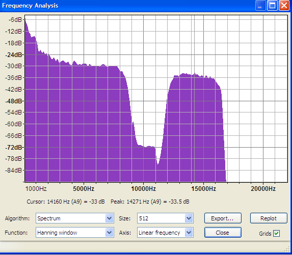

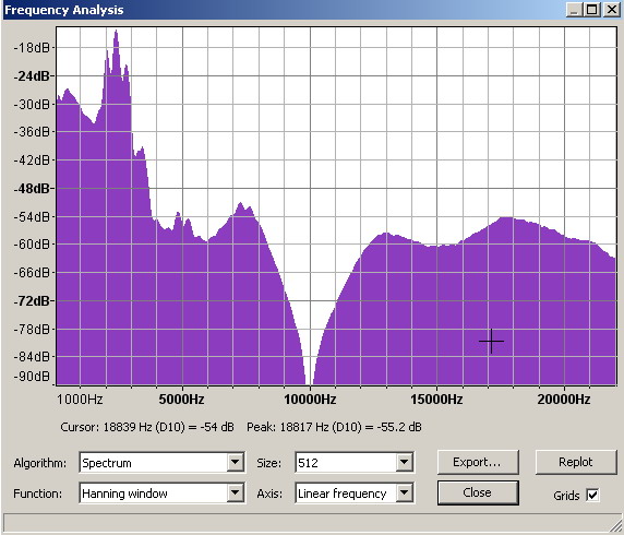

I noticed something weird, I wanted to make sure this was normal.
After I applied the band stop filter, I used plot analyze. It looked good. Perfect actually.
Below is a picture of what I mean.
Then after I exported the file. I then started a new project and imported the above mentioned file after applying the band stop and after I exported ( kind of a way of double checking.)
I checked using plot analyze again and, it didn’t look so pretty… It didn’t look as goo at all.
That picture is not as bad as it looks.
The stop band is about 40 dB quieter than the surrounding audio. -40 dB is about 1% of the original level (99% lower) though it could be much better.
If you export in a compressed format such as MP3 (which I’m guessing you have), then the data compression will introduce some noise into the stop band, and that is what you are seeing in the spectrum plot.
If you export in a high quality audio format such as WAV, the stop band will remain virtually silent.
If you need the export in a compressed format, then a high bit rate MP3 will retain the stop band better than a low bit rate MP3. Ogg format will retain the stop band better than MP3 format.
