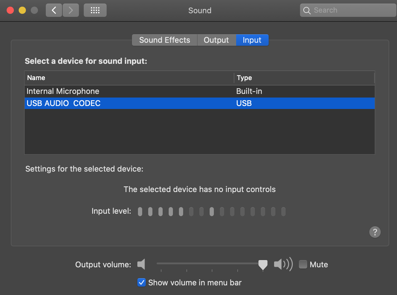

Are you seeing a signal level in the Mac Sound Input settings?
Yes, I am. It shows the USB device and is the signal is moving with the audio but there is no sound.

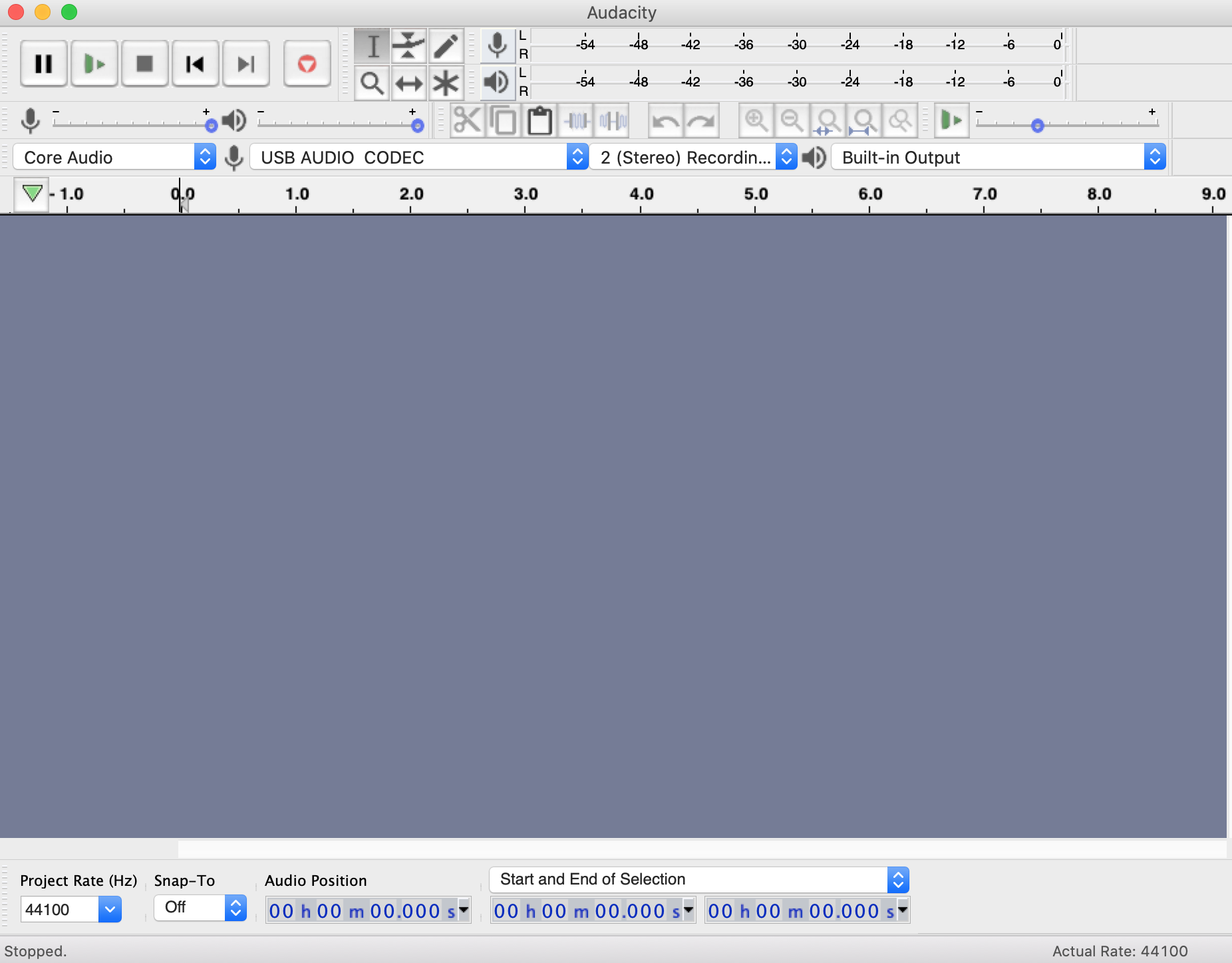

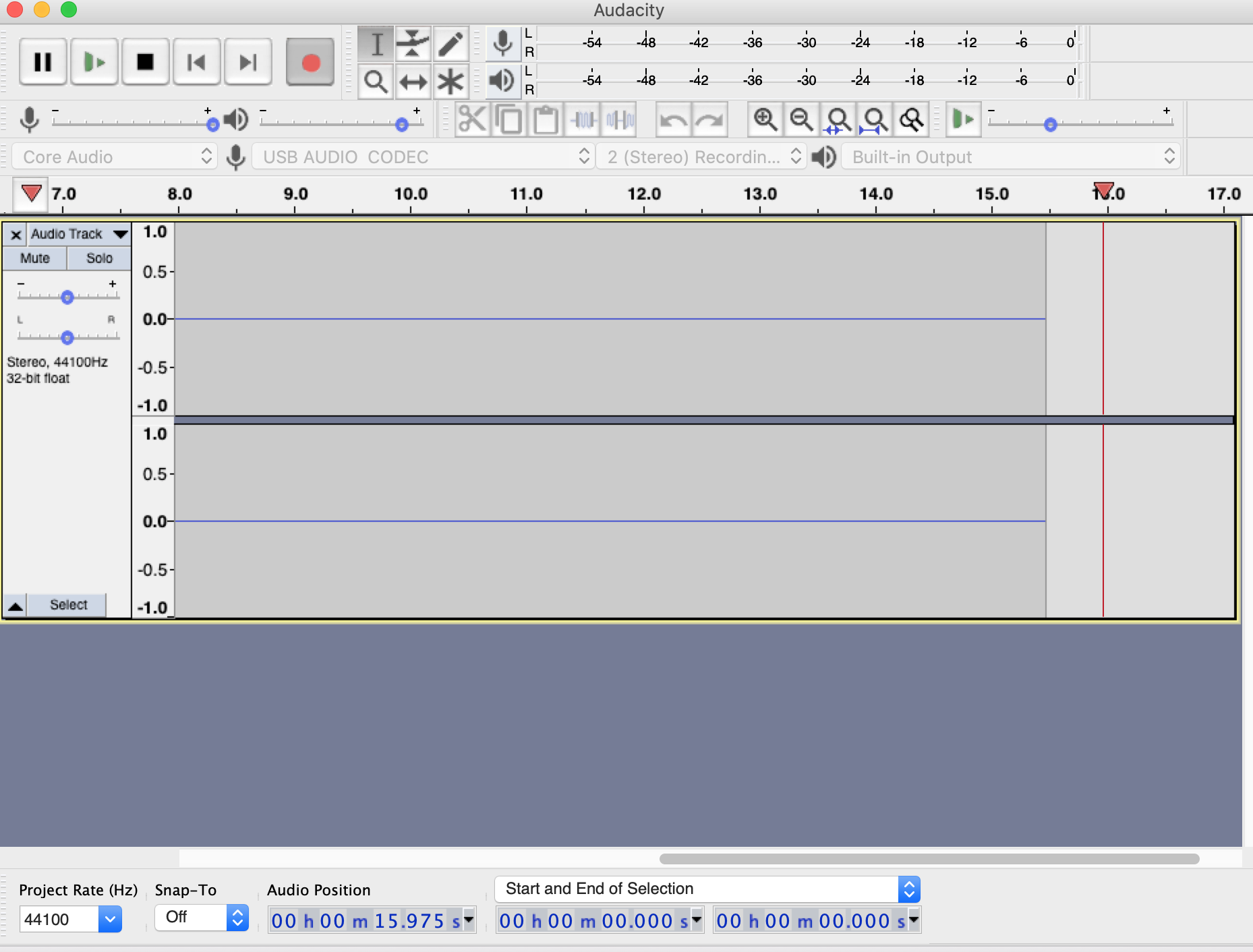

Here are two screenshots while the record is playing. Sounds recognizes the audio but Audacity does not. It was working fine before Catalina.

Here you appear to say that Audacity records “silence”. Is that not the case?

If you try to amplify that recorded track, what happens?
Does the Amplify effect say that the “New peak amplitude” will be “-Infinity”, or can you actually amplify the track?
