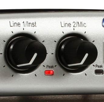

Here it is. According to the knobs on the front, this “stereo” device (I don’t think they ever call it that, right?) is actually aggressively two channel. Instrument on the Left and Microphone on the Right.

The Alpha is not a Mixer. You can’t start re-assigning which sound channel goes where. That’s what you bought.
You can tear everything apart in Audcity post-production and put the sounds where you like. That does make Overdubbing/Sound-On-Sound a little rough. Were you planning on cranking out a podcast with little or no post production?
When you record “mono” you get “channel 1” from the Lexicon alpha, which is the instrument channel. The mic input on the Lexicon alpha is “channel 2”. There is no way to set the mic input to channel 1 on the Lexicon alpha, and Audacity does not have “channel mapping”, so recording stereo is the only way to record channel 2 with your setup.
To get the Mic channel you have to record stereo, then in Audacity you can “Split Stereo to Mono” and delete the empty track (Splitting and Joining Stereo Tracks - Audacity Manual).
