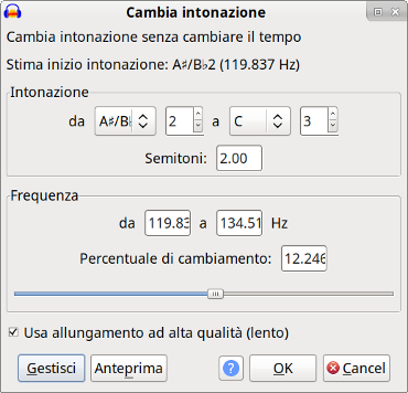

It is normal for the “percentage” to change when you change the amount in semi-tones. With “semitones” set to 2.0, the “percent change” should show “12.246”.

In that message, the range “from -99 to 3000” refers to the “percentage” setting.
Your percentage setting should be 12.246 (which is clearly well within the range).

The “decimal separator” should automatically display as a comma or as dot, according to whichever is native for the language settings.
What language is Audacity set to?

I setted in Italian
This works for me;
