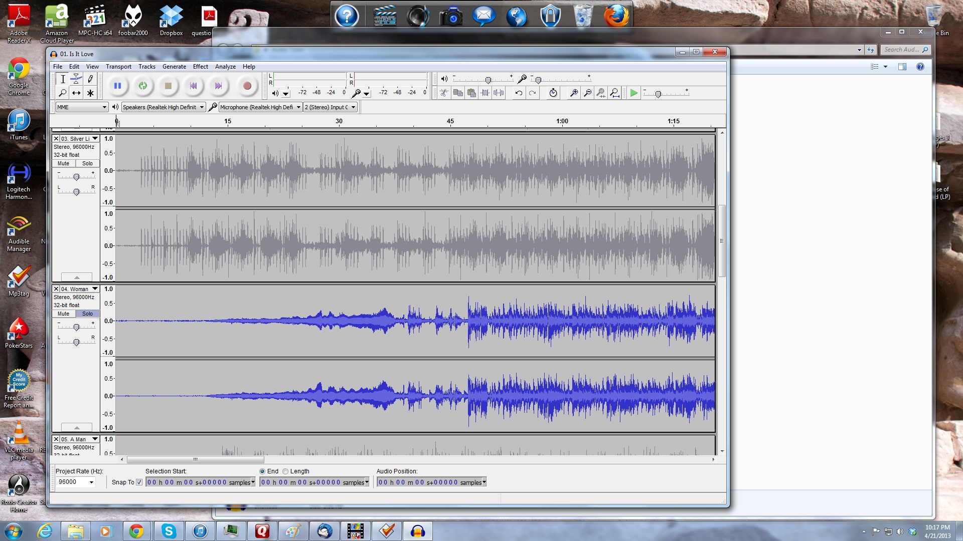

aud_project.aup (418 KB)

Is the attached the problem project? There are nine stereo tracks, and no separate clips in those tracks, so there should be no split lines.

In the project file AUP you submitted, there are no separate clips in any of the tracks (as I said).
The screenshot you submitted shows no black vertical lines.
